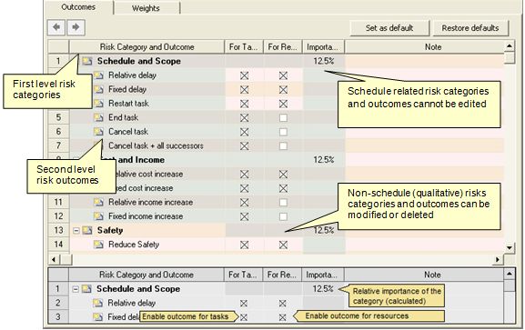

Non-schedule risk categories have been added for your convenience in
helping you construct your risk breakdown structure and risk
register. You may add any new non-schedule risk categories and risk
outcomes.

If you define risks with outcomes belonging to the Schedule and Cost
risk category or Cost and Income risk category, you must have a
project schedule. These risks must be assigned to tasks and
resources: they can be either global or local. However if you have
non-schedule risk, such as safety, quality, etc. you do not
necessarily requires a project schedule.
• One risk may have different outcomes. For example, “Low
quality supplies” can affect quality and can affect safety.
RiskyProject would calculate impact of this risk on safety and
quality separately, and then combined impact on all risk categories.
• You can enable/disable risk outcomes. Once disabled, risk
outcomes will no longer be available in any other risk assignment
view.
