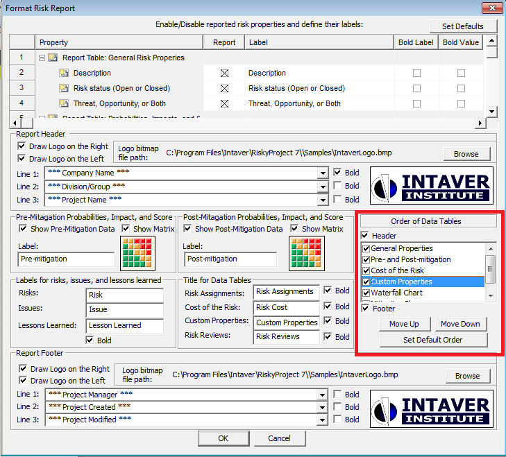

How to change an order of tables in Risk Report? I just want to show Custom properties of risk above general properties.
Jason
Re: How to change an order of tables in Risk Report?
You may use Customize Risk Report dialog available at the left bottom corner of Risk Report view. In this dialog use Order of Data Table section. Select data table and click on Move Up or Move down button. The data table will be moved in the report accordingly. The settings can be changed for all future projects.
