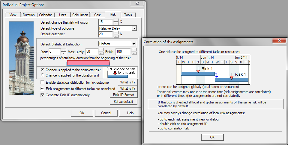

In recent version 6.1 we added extra option to correlate risk assignment:
http://www.intaver.com/images/RP_RiskAssign.png

If have the same risk assigned to different tasks in RiskyProject, are these assignments corrected to each other or not?
Project Manager, PMP
Re: Defining Event Chain
Risk assignments are corrected to each other by default. However you may change it by going to Schedule->Project Options->Risk tab. There is a check box there, where you can disable default correlation of risk assignments. In this case risks assigned to different tasks will occur at different moments.
