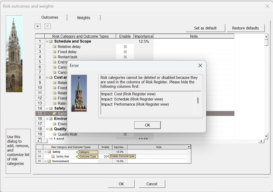

I tried to remove the Safety, Environment, Quality, Legal, and Tech categories but it says they are being used? This came up after we added the additional impact properties that it is telling me to hide?

Here is what you probably saw:
Unfortunately, you have to hide to all category columns being shown in the view, remove the categories and then reinsert the columns. To avoid this, set up the Risk Categories as the first step when setting up your Risk Register as it is a pain to remove them afterwards.
