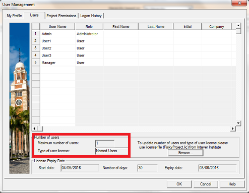

Does RiskyProject enterprise support concurrent users?
- Posts: 1062
Re: Concurrent users
This has a yes and no answer. First, we do get asked this about RiskyProject Professional and Lite and the in these cases the answer is a definite no. The licensing on the desktop solutions requires every computer that the software is installed on requires a license key.
For RiskyProject Enterprise the answer is a bit more nuanced. Technically, the licensing system supports concurrent licensing. However, we recommend named users for a couple of reasons:
1. For concurrent users these is data integrity issue in cases where users forget to log off
2. Cost – Licensing cost of concurrent users is substantially higher than named users.
