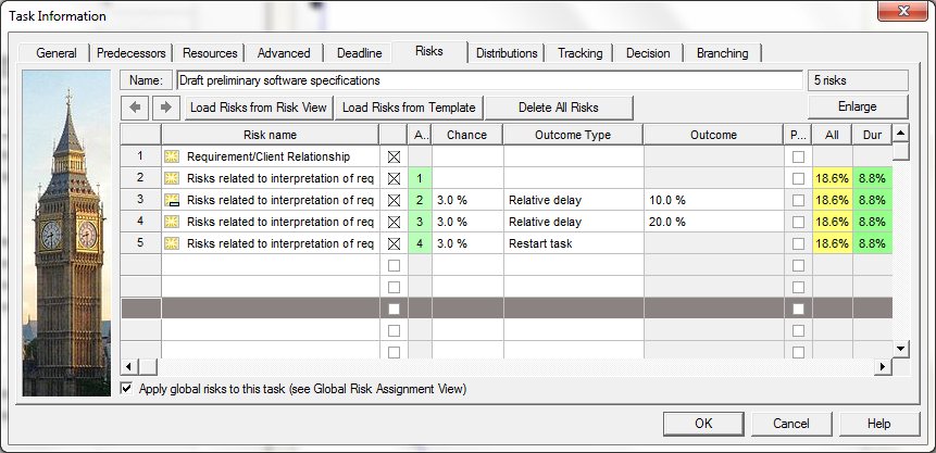

Is there an easy way to quickly view how all project risks are assigned? As part of our project reviews we someway to show and justify our risk assignment.

In order to perform schedule risk analysis using Monte Carlo simulations with risk events or risk driver, you need to assign risks to tasks or resources. There are several ways to view how your risks are assigned to the project. If you would like to see the risk assignments for each task, you can go to the Task Information > Risks tab. This will list each risk that has been assigned to the task.
