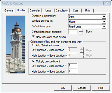

What are the units for duration and work? Where can I change it?

Duration and work units are calendar based units that go from Minutes to Months. Units for duration and work are set in the Portfolio (or Project) Options > Duration.
If you enter duration, the work will be converted into the Work units selected in the Duration options.
