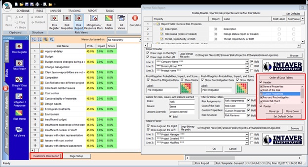

How to change order of tables in Risk report (for individual risk)?
Re: Customizing tables in the Risk Report
You can change the add, delete or change the order of any of the data tables in the Risk Report using the Format Risk Report dialog box.
To change the order of the data tables:
1. Open the Risk Report.
2. Click the Customize Risk Report button.
3. In the Order of Data Tables group box, select the table you would like to move.
4. Click the Move Up or Move Down buttons to reorder the tables.
5. Click OK to save the report.
