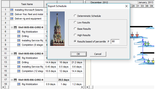

I noticed that from the Launch menu, it lists several tools including MS Project. How does this work and will it send the results of my analysis to MS Project?

If you run a risk analysis in RiskyProject, you can automatically export it back to MS Project either as the original plan or based on a certainty level (percentile) based on results of the simulation.
To export you results to MS Project.
1. Run a simulation.
2. From the File menu, choose Launch and then Microsoft Project. The Export Schedule dialog box opens.
3. Select either Deterministic (the original plan) or a percentile. Low and High are defined in the Project Options > Calculation. By default this is P10 and P90. Or you can enter a custom percentile.
4. Click OK. The schedule will open in MS Project.
