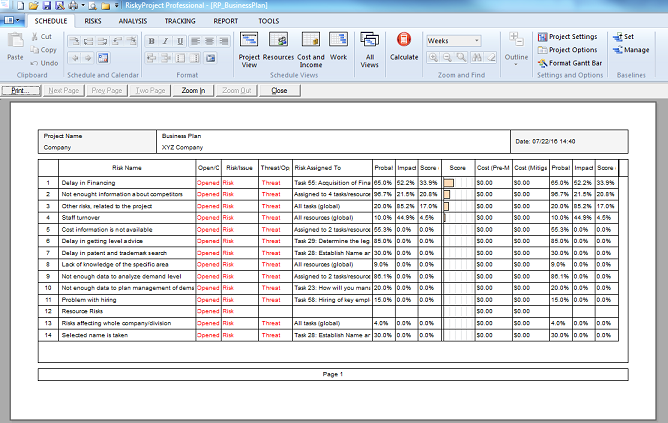

How can I print risk register report - all visible risk in the risk register?
Posts: 1041
Re: How can I print risk register report
You can print Risk Register report by simply clicking on File -> Print -> Print or File -> Print -> Print Preview in Risk Register or Risk Properties view. It works the same way as in all other views, such as Project view, Risk Mitigation View, etc. It is always possible to print whatever is presented on the risk register. Report will repeat the order columns in the risk register. You can define maximum number of columns for printing as well as row height for printing using File -> Print-> Page Setup dialog. Row height also controls font height, because RiskyProject will fit test to the row.
