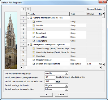

Can I define default risk properties on my computer? I would like to use the same set of risk properties for all projects.

If you use RiskyProject Professional risk properties are save on your computer in the system registry and can be used for all new projects. If you use RiskyProject Enterprise, you project properties are saved in the database.
When you go to the risk properties dialog (Risk -> Risk Properties) you will not find a button to save risk properties as default. It is because when you update risk properties they are saved in the database automatically each time when you update them.
