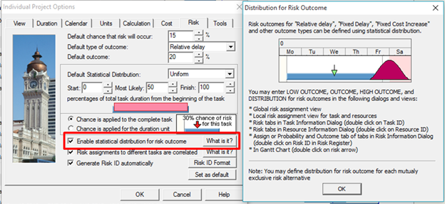

How do I enable probabilistic outcomes; it is not there by default

Just to remind you the risk outcome for fixed and relative duration and cost increase as well as for few other risks outcomes can be defined by statistical distribution.
By default the probabilistic outcomes are not enabled when you install the software. You can enable statistical distributions in the Project Options > Risk > Enable statistical distribution for risk outcomes as shown in the screen shot below. In addition, it includes the context help that is available for this option. You can also click F1 to open the online context sensitive Help for this dialog.
