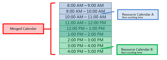

If you have two or more resources each with their own calendar assigned to a task, then the working time is a merger of the two resource calendars. Merging works by overlapping calendar exceptions. For example, if calendar A has Monday day off and calendar B has Wednesday day off, the combined calendar will both day non working. The same is true for hourly exceptions:
