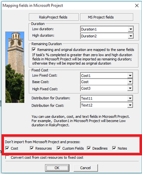

How many tasks (resources, etc.) can I import from P6 or MS Project? Are any limits?
Posts: 1047
Re: Number of tasks
There is no practical limit as you can theoretically import more than 100,000 - 200,000 tasks. In reality, you are most likely going to run into the limits of your computer (i.e. memory and cpu) where it becomes overloaded and takes extremely long times to respond to commands. If you are using MS Project 2010 or later the Addin allows you to exclude unnecessary data such as notes or custom fields. On very large schedules, this can significantly reduce the computer resources required to run simulations.
