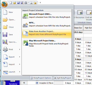

To import the risks, in RiskProject choose File (icon in the top left) > Import > Risks From Another Project. Browse to the original *.alm file and click OK to import the risks.
