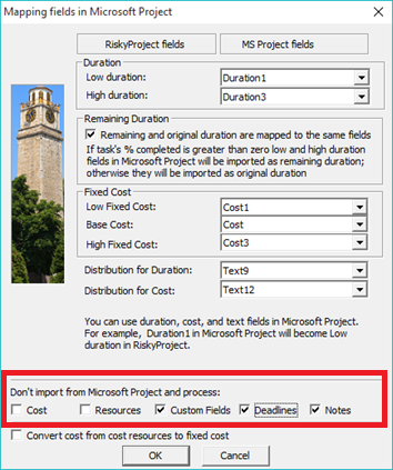

You can exclude this data using the Field Mappings dialog box. In the example below, Custom Fields, Deadlines, and Notes will not be imported into RiskyProject.
