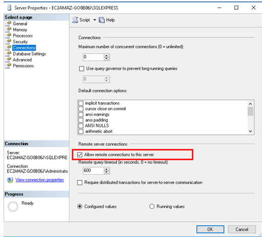

2. Right click on the server and select the Properties option.
3. In the Server Properties dialog under the Connections tab check the Allow remote connections to this server option:

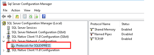

5. Under the SQL Server Network Configuration select Protocols for <your server name>:

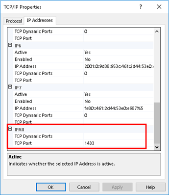

Make sure that TCP/IP protocol is enabled and right click on TCP/IP and select the Properties option. In the TCP/IP Properties dialog select the IP Addresses tab and scroll down to IPAII. If the TCP Dynamic Ports dialog box contains 0, which indicates that the Database Engine is listening on dynamic ports, delete the 0 and set the TCP Dynamic Ports to blank and TCP Port to 1433. Port 1433 is the default instance that SQL Server uses:

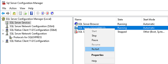

6. When you click the OK button you will be prompted with a message to restart the service. In the left pane of SQL Server Configuration Manager click SQL Server Services, right-click SQL Server<instance_name>, and click Restart:

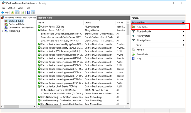

8. In the Windows Firewall with Advanced Security dialog click on the Inbound Rules option and select the New Rule command:
