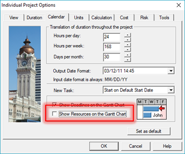

I have a lot of information on my Gantt chart (risks and links) and would like to hide the resources. Can I turn them off?
Re: Showing resources on the Gantt Chart
Yes, you can toggle your resources on or off on the Gantt chart. In Project Options > Calendar there is a check box to turn resources on or off on the Gantt Chart.
Remember to click the Set as default to save this as your defaults before exiting the Options.
