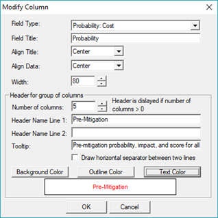

How can I add a 2nd header to the risk register that covers more than one column, similar to the Pre-Mitigation?

With the release of version 7, you can now add an additional summary header over 1 or more columns in the risk register.
To add a summary header, right-click on the first column to which you want to have under the summary header and chooser Modify column.
In the Header for group of columns options, enter the number of columns you want the heard to span and the name for the header in the Header Name Line 1. You can also modify the colors for the background, text, and outline. A preview of the header is shown below the color options.
