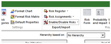

To Isolate the impacts of uncertainties you can disable all risks in the Risk ribbon.

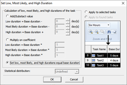

To isolate the impact of uncertainties is more difficult. I would recommend making a copy of the file and then in the Project view, select all the activities, right click on the Activity number column (far left) and from the shortcut menu choose Set Low High Duration or Set Low High Cost.
In the dialog box, click the Set Lo, and High duration equal to base.
