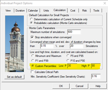

Contingency is not automatically calculated, but you can set up your results so that the High results equal the percentile level that you want to use contingency. In the example below, in the Options > Calculations, we have set the High results to P80.

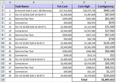

In the Simulations Results report, you can set up the view to display the Base (Original Costs) and High (p80). For simplicity, the activities have been collapsed to show only those activities to which contingency will be applied and measured. To quickly calculate the contingency, copy and paste the results to Excel. In version 7.1, you can export the view to Excel.
