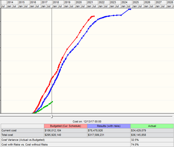

Does RiskyProject calculate EVM indicators?
- Posts: 1042
Re: EVM indicators in RiskyProject
No, RiskyProject does not perform EVM calculations though we do show variances between actual and budgeted costs base in the Cost View.
We have shown a very simple way to perform project performance measurement with risk and uncertainties. Many organizations utilize much more advanced framework for measuring project performance called Earned value management (EVM). EVM was first developed in the 1960s, but became a practical methodology late in the last century when it was actively adopted by U.S. government agencies and in particular the U.S. Department of Defense.
