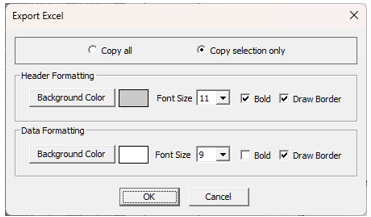

4. From the File menu, click Export > Microsoft Excel
5. In the Export Excel dialog box, click the Copy selection only option and click OK. The export to Excel will start.

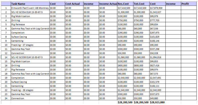

6. In Excel, select the columns that you want to calculate cumulative costs.
7. Use the Sum function to calculate the sum of all the selected costs.
In the example below we can see cumulative cost for Resources, Total Costs (original) and Mean. You can add additional cost columns such as the High results as required.
