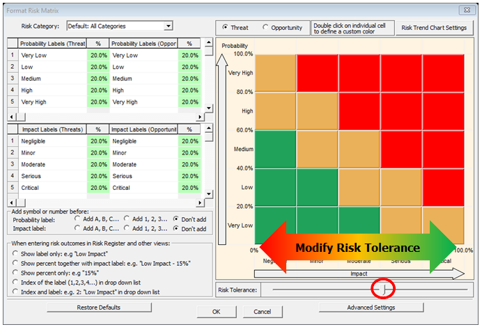

Is there any way to automatically update the Opportunity side of the Risk Matrix to mirror changes in the Threats side.
Re: Automatically update Opportunity Matrix
If you use the Risk Tolerance slider to modify the threat risk matrix, the opportunities matrix will update accordingly.
However if you modify the default color schemes in either the Threat or Opportunity matrix (see the topic “Probability and impact ranges and other Risk Trend Chart settings” in the User Guide) these changes will not be automatically updated in the other matrix.
