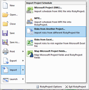

Can I copy risks from one project to another?

Yes and the method that you use depends on how you want to copy the risks.
If you have a project schedule with risks assigned to tasks, you can copy the risks and their assignments by using the Import > Risks from Another Project. This will import the risks as well as the risk assignments (based on Task IDs) from one project to another. This is useful process if you have project templates with the same or very similar logical structure. In this way you can transfer your risks with the risk assignments.
