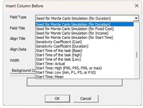

Is there a way to modify the seed values in RiskyProject?

Yes, RiskyProject has seed values for each task can be viewed and modified in the Project View as columns. By default they are not shown, but can be added to a view by right clicking on a column header and using the Insert command. From the example below, you can see that RiskyProject sets Seed values for Duration, Cost, Income, and Start Time. Of these, when Seed values are discussed they are commonly referring to Duration values.
