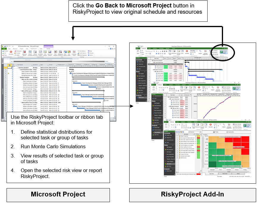

Here is how the integration works:
  1. The first time you open Microsoft Project after installing RiskyProject for Project, check to see that the RiskyProject ribbon tab is visible. You can enable/disable ribbon tab by clicking on Options in the File menu. Project Options dialog will open where you can select Customize Ribbon. You can also check the installed RiskyProject add-in by selecting Add-Ins.
  2. Create a schedule in Microsoft Project.
  3. Define uncertainties, perform calculation, and analyze results:
    • Define statistical distributions for cost and duration for selected tasks inside Microsoft Project; all statistical distributions are saved in a RiskyProject file.
    • Add risk-related information in the RiskyProject views if necessary: risk events, probabilistic and conditional branching, probabilistic calendars, etc.
    • Perform Monte Carlo simulations
    • View results of analysis and reports in Microsoft Project
  4. At any moment, you can go back to Microsoft Project and make changes to your schedule. All changes will be reflected in RiskyProject. However, if you make changes to the deterministic project schedule in RiskyProject, these changes may be overwritten by the Microsoft Project schedule.
  • You must save the schedule in Microsoft Project to use the integration between Microsoft Project and RiskyProject.
  • Always use the RiskyProject toolbar or ribbon tab in Microsoft Project and Go back to Microsoft Project button in RiskyProject to move back and forth between RiskyProject and Microsoft Project.
  • Once you have added risks and uncertainties to your schedule in RiskyProject, they will be always associated with Microsoft Project schedule.
  • Once you open a risk view from within Microsoft Project, your Microsoft Project file will be associated with the RiskyProject data file that contains risks and uncertainties for the schedule created in Microsoft Project.
  • Links between the Microsoft Project schedule and the RiskyProject file (alm extension) are saved in the registry. If you move the RiskyProject file into a different directory, you will be prompted to browse to find the RiskyProject file associated with Microsoft Project file.
  • If you move the Microsoft Project file, the link between Microsoft Project file and RiskyProject will also be broken. In this case, use the command File > Import > Risks from Another Project to find the RiskyProject file.
  •  If you make any changes in Microsoft Project and open RiskyProject using the toolbar or ribbon tab, RiskyProject will reflect the change; however, the risks and uncertainties will be adjusted proportionately. For example, your schedule in Microsoft Project has a task  'Project Inception' with a Base duration of 5 days and in RiskyProject you define Low duration as 2 days and High duration as 6 days. If you go back to Microsoft Project and change the Base duration to 10 days, when you return to RiskyProject, the Base duration will be 10 days (the same as in Microsoft Project); however, your Low and High durations will be adjusted proportionately (4 days and 12 days respectively. The same logic is used if you adjust the original fixed costs, work, income, lag, and start times.
  • Low, most likely, and high duration and costs are stored in Microsoft Project: duration1, duration2, duration3… Statistical distributions are stored in text fields in Microsoft Project. You must map the duration, cost, and text fields in Microsoft Project to low, most likely, and high duration or cost in RiskyProject using Field Mapping settings.
  • Some features of Microsoft Project are not supported in RiskyProject. For more information, see Frequently Asked Questions.
  • You can make changes to the schedule in RiskyProject. However, RiskyProject does not write these changes, such as task duration or task name, back to the Microsoft Project schedule. Therefore, we recommend that you do not to make any changes to original schedule in RiskyProject. Use RiskyProject to add risks, uncertainties and other risk related information.
  • If you want to transfer the original schedule updated in RiskyProject or results of probabilistic analysis to Microsoft Project, use File > Launch > Microsoft Project.
