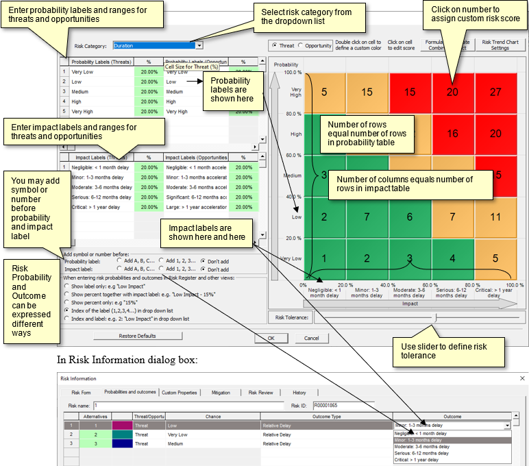

You can modify the Risk Matrix to define the risk matrix's number of row and columns, define labels and the risk tolerance display. These settings will be used in Risk Matrix view.
Risk Tolerance
The level of risk tolerance is displayed using color-coding (for threats: green: low risk, yellow: medium risk, red: high risk). A high number of green cells on the chart indicates a high risk tolerance. A high number of red cells on the chart indicates a low risk tolerance. Color-coding for opportunities is the opposite.
Number of Rows and Columns, Labels for Probabilities and Impacts
In the Format Risk Matrix dialog box, the number of rows in the Probability table corresponds with number of rows of the risk matrix, and the number of rows in the Impact table corresponds with the number of columns in the risk matrix. Therefore, to add or remove a row or column in the risk matrix, simply add or remove the label in the probability or impact table.
You can define probability and impact for different labels for each risk category. In addition, you may define different labels for threats and opportunities.
For example, if in the Duration category, the impact label for "Threats" is "Low: 1 month delay", the impact label for the opportunity in the same category is "Low: 1 month acceleration". If you do not define labels for a risk category, the default set of labels will be used. You may modify the default set of labels by selecting "Default" from the dropdown list and then editing as required.
Probability labels are used only in the Risk Matrix; impact labels used appear in the Risk Matrix as well as to define outcomes of each risk in the Probabilities and outcomes tab of the Risk Information dialog box.
For example, an impact label "Low: 1 month delay" will be shown on the horizontal axis of the Risk Matrix. In addition, when you define the impact of a risk, which has an outcome type "Relative delay", you will be able to select the outcome "Low: 1 month delay".
Risk Matrix: formatting
To format the Risk Matrix:
  1. Click the Risks tab. In the Settings group, click Format Risk Matrix .
  2. Select a risk category from dropdown list. "Default" category is used if you did not explicitly define labels for specific risk category.
  3. Modify the Intervals for Impact and Probability for the selected risk category.
  4. Modify the Impact and Probability labels as required for the selected risk category.
  5. Drag the Risk Tolerance slider to the left to set a low risk tolerance or to the right to set a high risk tolerance.
  6. Toggle between Threat and Opportunity to view how the risk matrix will look like for threats and opportunities.
  7. Define how risk outcomes in Risk Information dialog box or Risk Register will be shown:
    • As label only (e.g. "Low Impact")
    • As percent together with label (e.g. "Low Impact - 15%")
    • As percent only (e.g. 15%)
    • As index of the label (1,2,3,4...) in dropdown list
    • As index and the label: e.g. 2:Low Impact in dropdown list
  8. Add symbol or number before probability or impact label. For example, instead of 'Very Low' label you may use 'A: Very Low'.
  9. The define properties of the probability and impact range by clicking on 'Risk Trend Chart Settings'
  10. Formula to Calculate Combined Impact allows you define algorithm for impact calculation.
Define Custom risk scores
Risk scores are usually calculated as Probability * Outcome. However, if you have risk probabilities and outcomes expresses as index (1,2,3,4...) index and label (2: 'Low Impact') in the drop down list you may define custom nonlinear scores. These scores are shown in Risk Matrix in Format Risk Matrix dialog as number from 1 to 99 on each cell. For example,
  • index of low probability is 2 - second row from the bottom of risk matrix
  • index of critical outcome is 5 - last columns of risk matrix
  • score based on these indexes equal 2*5 = 10
  • it is possible to assign a number to this cell different than 10. To do just click on number and enter different number, for example 11.
Notes
You may change color of each cell by double-clicking on the cell. You may also define a name of each range, and order how different ranges are shown in the Risk Trend Chart, as well as the periodicity of the risk trend chart.
Your settings will be saved to the system registry for all new projects on your computer. These new defaults will not affect any previous projects. You can also restore the pre-defined set of categories and outcome types by clicking on the Restore Defaults button.
