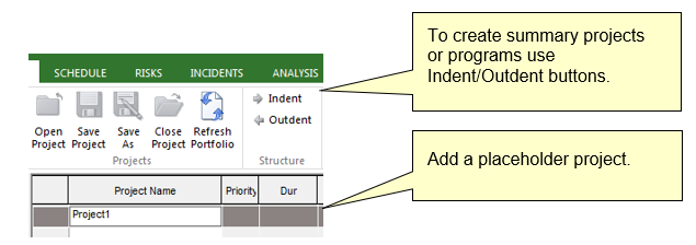

  1. Click the Projects tab. In the Project Views group, click any project view. In these views, you will be able to see all your projects. In a new database, there will be no projects shown in the views.
  2. To begin building the hierarchy and adding projects, first create a project. This will serve as a starting point to begin building the hierarchy. If the project contains any tasks or resources, it will be an actual project. Otherwise it will be a project placeholder. Project placeholders will not have a Gantt bar associated with them in any Project views: Portfolio Gantt, Risked Project, and Project Portfolio views. To add the initial project, click in the top row and type in a descriptive name.
  3. To add the project to the program, right-click on the project directly below the Program and choose Outdent,
  4. To create an empty row, right-click on the Project ID and click on Insert Project.By repeating these steps, you can create your a hierarchy, which will can include multiple programs and projects.
