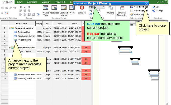

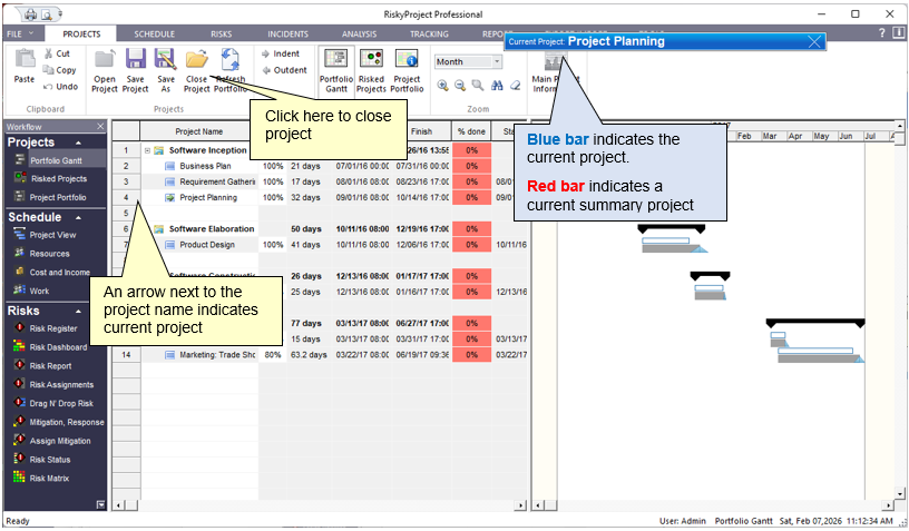

About the Current Project
Once you open a project it becomes the current project, and schedule or risk data that is added, modified or deleted is added at the current project level. The current project is indicated by either a blue bar for project or red bar for summary project at the top of the RiskyProject workspace. The current project is indicated with italics and an arrow next to the project name as in the below example: next to the project name.
A red asterix symbol indicates that the project is currently being edited.
If the Current Project bar is not visible, then you are currently viewing the Portfolio. This is especially important if you are in the Risks views, as this would mean you are looking at the Portfolio level risk views.
