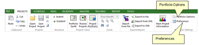

To change Portfolio Options or Preferences:
- Click the Projects tab.
- In the Portfolio Settings group, click Portfolio
Options or Preferences.
