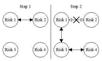

If you define a correlation between risk 1 and risk 2, and then
define a correlation between risk 1, risk 3 and risk 4, the
correlation between risk 1 and risk 2 defined in the previous step
will be removed. Therefore, if you want to setup correlations
between many different risks, you must perform this in one step.
