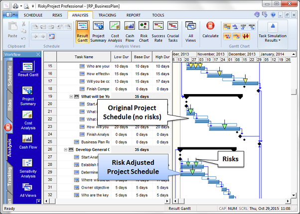

Risk Adjusted Project Schedule in RiskyProject
In RiskyProject, one of the most compelling views to present the risk adjusted schedules that allow you to compare your original deterministic schedule with the results your analysis is the Result Gantt. The Result Gantt view provides a Gantt chart with two bars for each activity. The first clear bar is the original activity and the second bar (we will call it the results bars) shows the results of the analysis.
The results bar can be modified to show the Mean with Low and High results as probability distributions or separately. As the High results can be set to reflect specific confidence levels, it can be set to match your contingency targets (e.g P-80). With the Result Gantt you can generate an easy to understand visualization of a risk adjusted schedule with realistic contingency.
