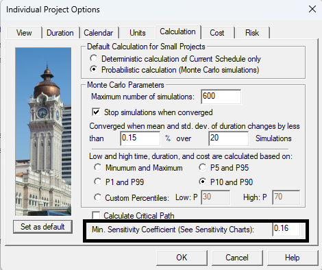

We have been running simulation on a large schedule, but only seeing a few results in the Sensitivity View. Is there a way to see more results?

Best Practice: Setting Sensitivity Coefficient Threshold
There is a threshold that can be set for viewing sensitivity results, where any results that do not meet the sensitivity coefficient threshold are not show as way to simplify the analysis of schedules. If you many activities with similar levels of risk and uncertainty, the sensitivity coefficients will often fall below the default setting.
The Sensitivity Threshold is set in the Project Options > Calculations tab. You can experiment with the coefficient to see the level that provides the number of results that you want to view.
