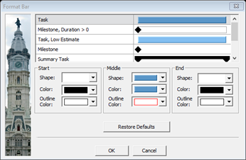

How do you change the appearance of the Gantt bars in RiskyProject Enterprise?
Posts: 1070
Re: Gantt bar appearance
You can modify the color, shape and outline color of the Gantt bars. Click Schedule > Settings and Options > Format Gantt Bar.
You can modify the color, shape and outline for all of the Gantt bar types available in RiskyProject. These types are Project, Milestones, Summary Tasks, Task Low Estimate, Task, Task High Estimate. To modify a bar, select the Gantt bar type and modify the Start, Middle, and Finish settings.
