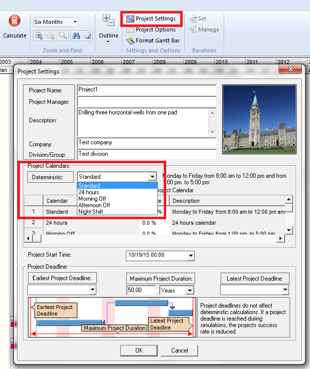

Project calendar can be different. You can define it for individual project. It is defined in Schedule -> Project Settings. Project calendar is a default calendar for individual project. Each particular resources or tasks may have its own calendar. Generally RiskyProject uses the same logic as Microsoft Project. Project calendar affects results of Monte Carlo simulations. If you brings schedule created in Microsoft Project or any other software into RiskyProject, project calendar will be imported.
