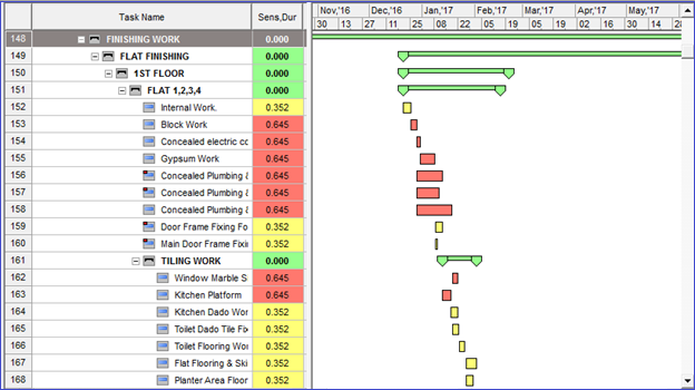

Short answer is yes, best practice is to add uncertainty to all your project activities when performing Monte Carlo simulations. In reality this could be further refined by add “that can vary in duration” to this advice. Obviously deadlines fall into this category, but there are also some routine activities of very short length (~ 1 day) that can be safely ignored.
However on deterministic schedules only a relatively few activities will be critical. If you do not add uncertainty to the other tasks, the Monte Carlo schedule analysis will not capture the impact of near critical activities, merge bias, and the portfolio effect. In probabilistic project analysis, there can be multiple critical paths where near critical activities can become critical. The Crucial task view is a visual representation of how often activities will land on the critical path. In addition, if you only add uncertainty to critical activities, this may cause errors in the sensitivity analysis.
