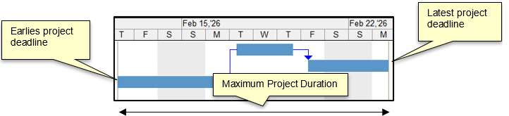

  1. Earliest Project Deadline: if any task is started or finished before this date, the task and the complete project will be marked as canceled for the particular iteration. Start and finish time of the project will be adjusted. If the finish time of the task date is before the earliest project deadline, the task will have zero duration and begin on the earliest project deadline.
  2. Latest Project Deadline: if any task is started or finished after this date, the task and the complete project will be marked as canceled for the particular iteration. The start and finish time of the project will be adjusted. If the start date of the task is after latest project deadline, the task will have zero duration and begin on the latest project deadline.
  3. Maximum project duration:: actual project start time plus maximum project duration is the maximum project finish time. It affects the project schedule the same way as Latest Project Deadline.

Earliest Project Deadline and Latest Project Deadline are shown as red vertical lines on the Gantt chart. You cannot scroll Gantt charts beyond these dates.
