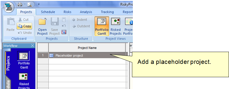

- To begin building the hierarchy and adding projects, first create a project. This will serve as a starting point to begin building the
hierarchy. If the project contains any tasks or resources, it will be an actual project. Otherwise it will be a project placeholder.
Project placeholders will not have a Gantt bar associated with them in any Project views:
Portfolio Gantt, Risked Project, and Project Portfolio views. To add the
initial project, click in the top row and type in a descriptive name.

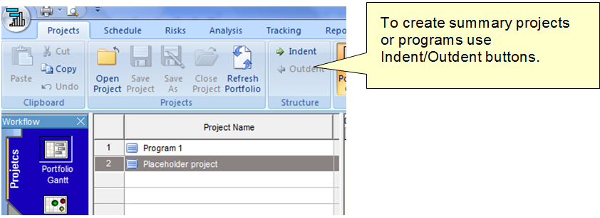

- To add the project to the program, right-click on the project directly below the Program and choose
Outdent,
- To create an empty row, right-click on the Project ID and click on
Insert Project.By repeating these steps, you can create your a hierarchy, which will can include multiple programs
and projects.
