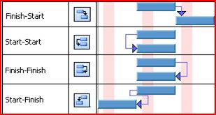

Task LinksAll projects require that the WBS tasks be performed in a certain order. These relationships are defined in RiskyProject using the four linking buttons located on the standard toolbar.
The four types of task dependencies are show in the following figure:
If you want next task to be predecessor of previous task, for example task 5 to be a predecessor of task 3, you will have to use Predecessors tab in Task Information dialog box . You should also use Predecessors tab if you want to define lag time greater than zero. Remember the following rules:
