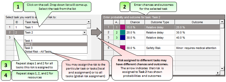

- Open the Risk Register.
Double-click on the risk to which you want to add properties.
Click either the
Assign to tasks or resources tab.
Depending upon whether you are assigning local or global risk to
a task or resource click on the first empty row in either the
Assigned to tasks or Assigned to resources
tables.
Select the task or resource from the drop-down list. You may
select "All Tasks" or "All Resources" for global risk assignments.
If you select a specific task or resource, it will have a local risk
assignment.
Click the row ID cell the item you just select
to enable the Selected assignment
table to the right. This is where you define the risk assignment.
Click in the Chance cell to start entering the
Chance, Outcome Type, and Outcome of the
risk.
Select the Moment of risk distribution from the drop-down list.
If it is triangular, you must define the Start, Most Likely, and
Finish parameters. Moment of risk is available only in RiskyProject
Professional.
Click in an additional row to enter a mutually exclusive risk
alternative. A risk alternative is a different outcome from the same
event.
Use the Pie Chart for mutually exclusive risk alternatives to as a
guide for how they affect the overall chance that the risk will
occur.
if you do not enter chance, outcome, results, or moment of risk
assignment will not be saved even you selected task or resources.
